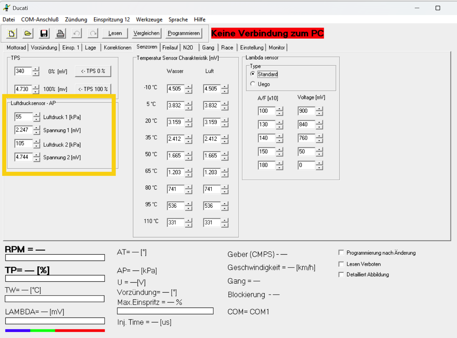

Schaut mal hier:
Letztendlich sollte es aber dem Ignijet ziemlich egal sein, da es sehr frei konfigurierbar ist und im Endeffekt nur mV und kPa Werte als Referenz benötigt.
Hier mal ein Screenshot aus dem Menü:
Und die Beschreibung aus der Anleitung:
"13. Air pressure sensor APS.
The input is designed for various types of APS sensors used in motorcycles. It is designed to take voltage of 0 to 5 V. Selection
of correct is carried out on the basis of motorcycle selection in the DUCATI.EXE software. The characteristics of the sensor
can be modified in the DUCATI.EXE software. APS is powered by the means of reference voltage + 5 V and SENSE GND.
In case the APS is missing in the motorcycle system, the function of the air pressure sensing is taken over by the dashboard
that sends the information to ECU through the medium of CANbus. In case both the APS as well as dashboard are missing, the
unit sets the correction as if the air pressure is 100 kPa.
14. ATS air temperature sensor.
Option 1) The input is designed for standard thermosensors used in motorcycles. In these sensors the dependence of resistance
on temperature is generally the same as in the case of the water temperature sensors. The characteristic of the sensor can be
Option 2) The input is used for sensing of the gearbox neutral position, in this case the atmospheric air temperature values are
received by the unit from the dashboard after the CANbus."
Edited by Duc-Schmidti
